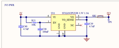

In that case either:
1- This regulator is internally short-circuited :
2 - Or you have a short circuit on the board.
To differentiate between the two cases you need to unsolder SB2 and fit again JP2.
If LD6 is lit: the regulator is broken. You need to purchase another board.
If LD6 is off you have a short circuit on the board. In that case you need to check your board and find if VDD is short-circuited.
Hope that helps.

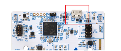

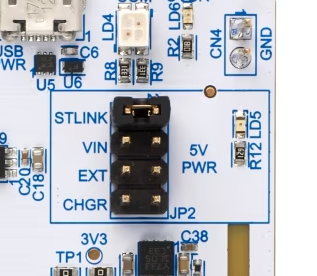

What is the position of the jumper here?:
And how are you powering the board? via ST-Link?
2025-03-05 12:21 AM
The position of the jumper is same as the image.
The board is been powered by a USB cable
I have changed the USB cable and tried, still the same
2025-03-05 12:33 AM
USB cable connected to CN1 (ST link USB connector)?:
2025-03-05 12:35 AM
Yes, I have connected in that USB port

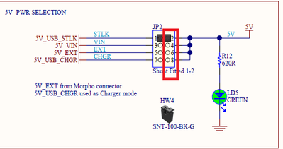

1- Then, check if you have 5V on JP2 on one of these pins:
LD5 is On?

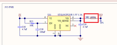

2- After, check if you have 3.3V on SB2:
