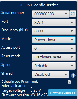

Back in Programmer,
For the record, I was able to connect before the upgrade + flash.
The upgrade mode seems to work still.

Solved by programming with option "Power down"
1 REPLY 1
CarlosMartinez
Associate
