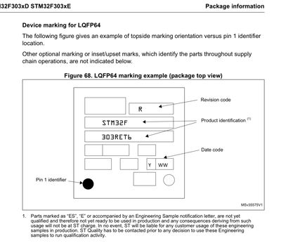

>>What is the cause of this?
Probably counterfeit parts..
Perhaps a large, close, sharp, well focused picture of the top markings of the IC ?

Ok, but they are not psychic either, so without some markings, or trace codes from the packaging, or knowing how these part(s) were sourced it's going to be hard to know.
You could try also accessing with an ST-LINK and STM32 Cube Programmer

Dear @Ukazu ,
« When I start debugging on the target microcontroller (STM32F303RDT6), **Not a genuine ST Device! Abort connection** »
is that correct the flash programming ( Erase and write , has been done successfully first on this part) and then when starting to debug : you got this message ?
if possible indeed to have the product Top marking on this LQFP64 package and if possible the UID - unique ID signature so we can check it from our factory side .

No, it is not possible to erase or write to flash. Therefore, debugging cannot be started.
I tried two combinations: Keil+ULINK2 and Keil+STLINK, but they were unsuccessful.
I purchased this microcontroller from an online shop. A world-famous online shop for device parts.
I don't have a target microcontroller at the moment, so I don't know the TOP marking.
We will contact you as soon as we know.
Thank you
