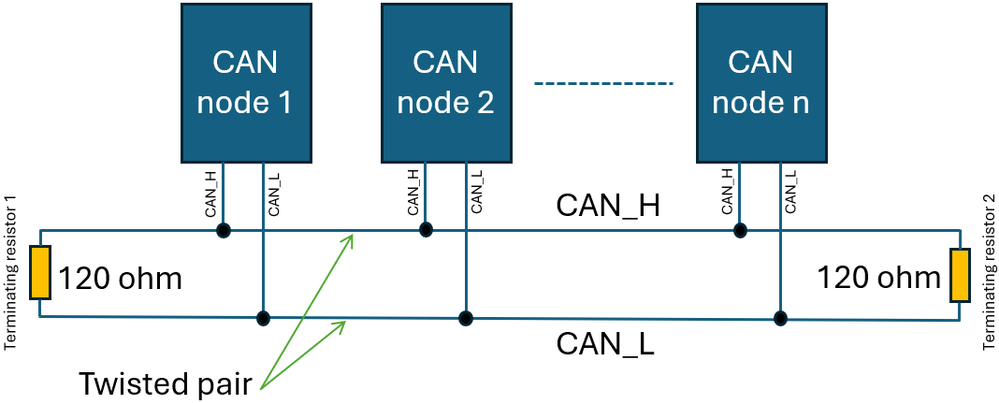

Are you sure this is the only hardware you are using?
Where is the CAN transceiver? where is the second node that needs to be connected to the CAN bus? where are the terminating resistors?
And this is what you need as a minimal hardware to establish a successful CAN communication in Normal mode. You need at least two CAN nodes connected together. This is what you need for CAN communication in Normal mode:
This is already explained in the section 3. Hardware setup in the mentioned article. The two nodes should have the same CAN bitrate and you must use an external accurate clock source (example: Crystal). HSI and other internal clock sources are not recommended for CAN operation in Normal mode.
CAN is not SPI or UART to probe the Tx with only one device. You need at least two CAN nodes to ensure the successful operation of the acknowledgement mechanism.
Or simply use External Loopback mode and probe the CAN_Tx pin. In that case you are not obliged to use a second CAN node.

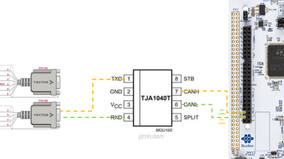

Hello @mƎALLEm ,
I have attached the HW sketch and the IOC file.

Are you sure this is the hardware you've adopted?
Tx/Rx transceiver side need to be connected to the STM32, while CAN_H and CAN_L need to be connected to the "CANoe"
2025-05-20 7:02 AM - edited 2025-05-20 7:05 AM
That looks entirely backward.
The CAN_H / CAN_L are the **BUS** side of the interface, the TX/RX is the STM32 side.
CAN_High to CAN_H
CAN_Low to CAN_L
GND to GND, ie common, like to the chassis of the vehicle.

hello @mƎALLEm
Yes you are coorect. So you go the picture of the setup.
