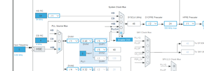

2025-05-20 9:13 AM - edited 2025-05-20 9:15 AM
No. You need to use 5MHz as Input frequency as I shared in the ioc file I've attached previously. You don't have any 24MHz source on the board. If you need your system clock set to 24MHz with a 5MHz as HSE input, this is the right configuration:
And you need to check if the STLINK-MCO is set to output 5MHz as stated in the article: How to use STLINK-V3 MCO output on Nucleo boards as a precise clock source for STM32

2025-05-15 1:45 AM
The pins are same in STM32H753 and STM32H723.
- To port I found one issue with the DIVN1/2/3 - minimum I can go upto x4 but in the example it is mentioned to have x1. - Attachemnt provided
- My hardware is NUCLEO-H723ZG - MB1364E.
- Sketch I have attached.
- I have gone through the 2 articles and I reverted my clock to 5mhz.
