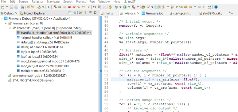

I'm using varadic in C and it seems that when I'm using float with va_args I get HardFault.
I have a runable example here: https://onlinegdb.com/2c6Q1hR-ZB
My question is: Why does I get a hardfault here? How can I solve this? Is there any flags in the compiler I need to configure so I can use float?
matrices[i] = va_arg(args, float*); <--- This gives HardFault
Have you tried debugging to find out?

Try double instead of float. And no pointer (*)
matrices[i] = (float)va_arg(args, double);
You cannot cast a regular type from a pointer. Does not even compile.

probably a stack overflow.
make all the local array in main static. especially
float Y[ITERATIONS * N];
hth
KnarfB
Ah I've missed that matrices[i] is a pointer. Then it won't work at all. Assign matrices[i][j] in a loop. va_arg does not return pointers.
