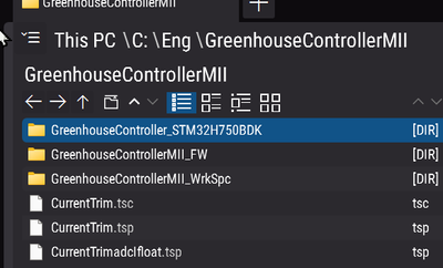

I have been meaning to post one of my projects to the forum for a while to help others with some of the trickier feature of the STM32 processors, but it is difficult as full project with TouchGFX are rather large. I tried Git Hub, but it said No to the number of files so I opted for DropBox with a link:
If it asks for a password i is
greenhouse1924
This file is a zip of the project and must be extracted to a folder c:\Eng to work. The project workspace is included:
Ignore the first folder that is just the Github stuff. The bottom three files are configs for ST Studio which I still use because the new monitor program is a dog.

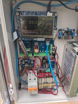

The project is incomplete as I haven't implemented the ethernet data transfer or the alarm system, but the project as is is now running the greenhouse albeit with no data link.
I designed a custom interface board that the discovery plugs into. It has an interface to an infineon based H-Bridge that drives the linear actuator for the greenhouse vent, a couple of temperature inputs using the LM135 abs temp sensor and six digital outputs. The board was developed in KiCad and a zip is attached. SEEED Studio did a nice job on the PCB, but I assembled the boards myself. NOTE: Use the TI Isolation Chip ISO7760DW not the one shown in the schematic as the schematic shows a bi-directional version.
