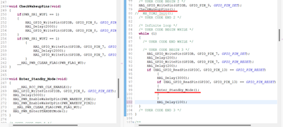

2024-05-01 6:48 AM
You can see the coding in the attached image.
When both WKUP pins are woken up, only the LED named GPIO_PIN_8 lights up.
So WUF2 is never HIGH.
GPIO_PIN_8 when woken up with pin 1,
GPIO_PIN_7 should work when woken up with pin 2, but GPIO_PIN_8 works even when I wake it up with pin 2.
