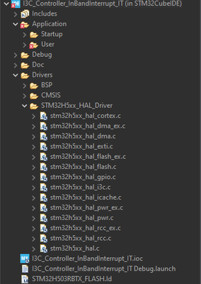

I am using STM32CUBEIDE and it can not recognize the function 'I3C_CtrlTimingComputation' & definition 'I3C_PURE_I3C_Bus'. I have generated the example 'I3C Controller Inband interrupt' from STM32CubeMx by selecting appropriate board(not using example from Git repo).
Are these functions/definitions not included when we generate code from STM32CubeMx? If yes, can you point to the specific files I should look for ?

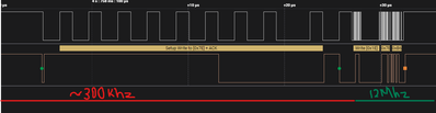

But the initial question the remains i.e. In one I3C message how can the frequency be varied by the controller in OD and PP phase. Usually the other controllers do this by themselves(not sure how, might be some sort of config).
The LL_I3C_CtrlBusConfTypeDef type has the same parameters as mentioned in the first post and lack the separate High Duration parameter for OD & PP.
Maybe following snap will help in clarification of what I'm trying to say.
Thank you for the support.

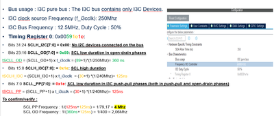

Hello @Asfand
I will share with you an example and let me know if this is helpful or not :
Best Regards,
Foued
2023-09-13 1:44 AM - edited 2023-09-13 2:02 AM
EDIT: With uneven duty cycle, i am able to achieve the desired functionality. So turns out these parameters are good enough.

After reading the definitions. I do not see a way of producing the desired waveform using these parameters. As the frequency difference(for ex:12Mhz-500khz) would result in a stretched duty cycle.
