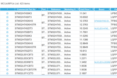

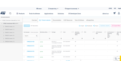

I suggest to use the online product selection on st.com (STM32 Microcontrollers (MCUs) - STMicroelectronics).
Product selector is applicable by Category. For example, below I'm searching within mainstream STM32 MCUs :

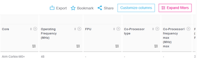

push the pink button expand filters:

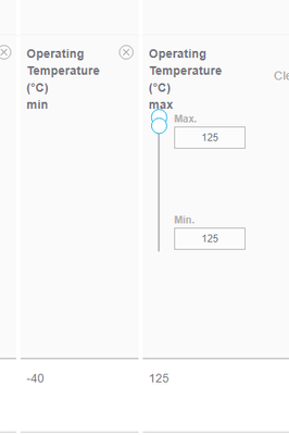

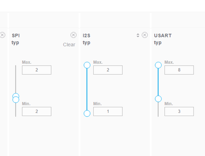

Apply the filters you need: below I put the min of SPI and USART that your rquested and Min/Max Temperatures:
As a result I got 17 MCUs in mainstream. You can follow the same filtering method for other STM32 highPerf, ULP and wireless
