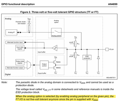

I have a question about 5V tolerant I/O in analog mode. When I look Figure 20. Basic structure of a 5-Volt tolerant I/O port bit in RM0377, i don't see the analog arrow as in figure 19.
Is it an error on figure or 5V tolerant I/O doesn't work in analog mode ?

Somewhere there is a note that pins in analog mode are not 5V tolerant. I will try to find it.
Edit: Can only find this:
And this, which says the analog switch is only closed when the ADC is activated. The pin will still be 5V tolerant if the ADC is inactive.

I see this note, but my question is : Do 5V Tolerant work in analog mode ? Because I don't see a link to analog mode in figure 20
No, they are not 5V tolerant when in analog mode and being used by the ADC.
Its just : only as digital input a pin can (FT_ pins) tolerate 0...5V signal.
As soon as you use any other pin setting, output or analog, ist always limited to vss-vdd (or vdda), 0...3v3 typical.
The ADC itself anyway working on vssa - vdda , so nothing else possible as ADC-input.
