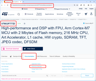

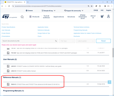

2024-03-25 4:18 AM
As always, Go to the Product Page, and look on the 'Documentation' tab:
Scroll down to 'Reference Manuals':
