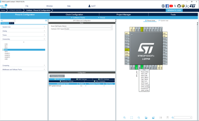

If you are using the SPI1 without MISO (PA6) (in Half-Duplex Master), you can configure the PA6 on any of the modes mentioned on the screenshot:
Best regards.

What I suggest you is to generate your project using CubeMX (peripherals and pinout initialization and configurations). Then, do the codding part.
Best Regards.
