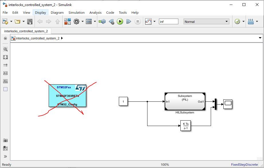

You don't create .ioc file by yourself. The STM32-MAT/TARGET generate it automatically so you don't need MCU config block.

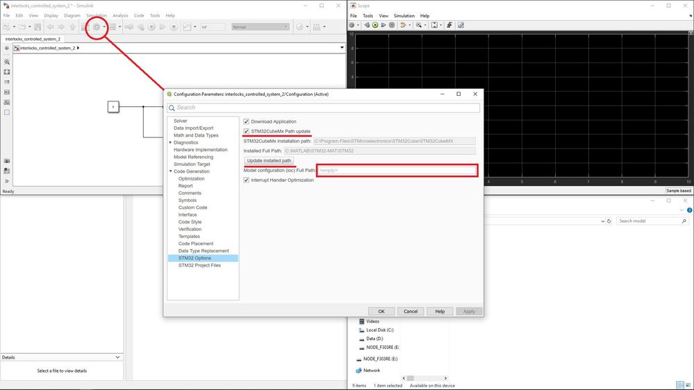

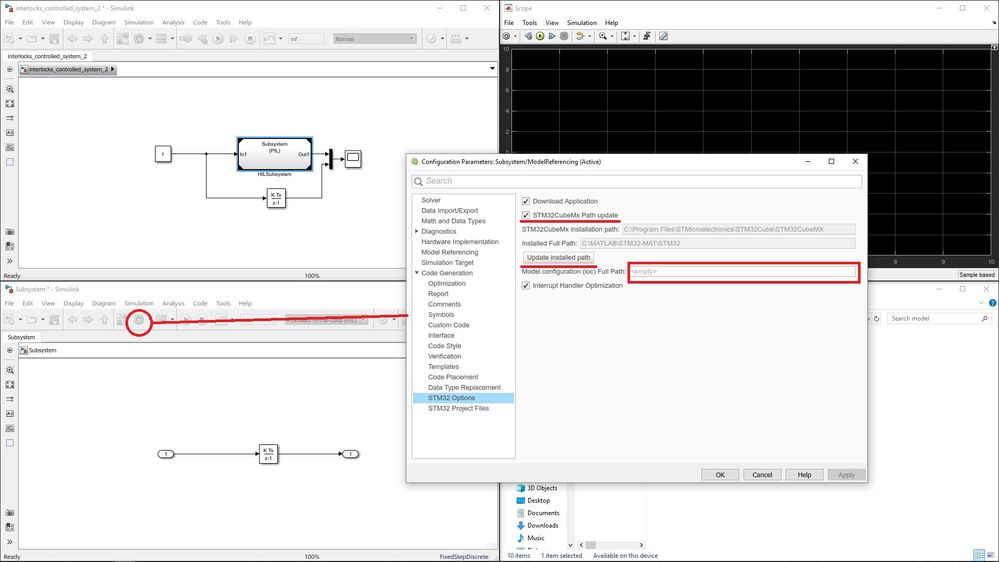

Before build your project, please check Configuration Parameters setting of System and Subsystem as show in below picture.

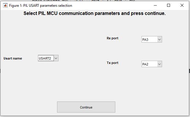

I used EWARM toolchain and USART2 for communication.

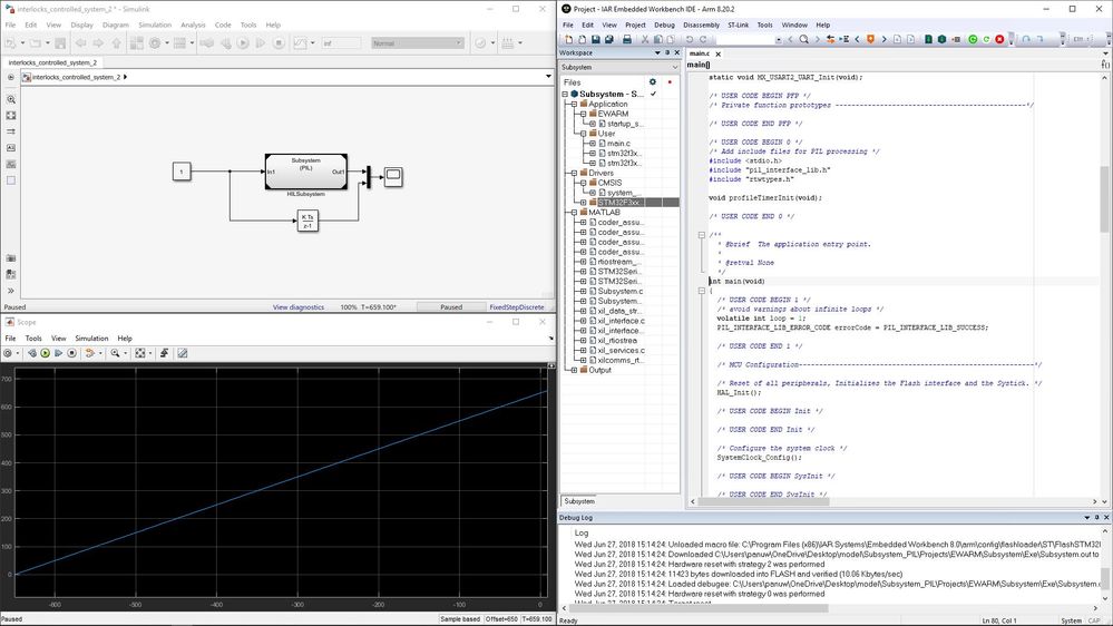

And this is the result.
