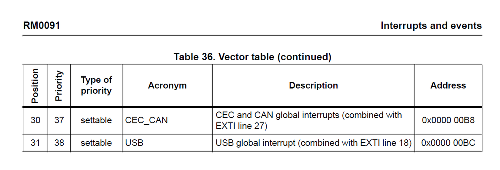

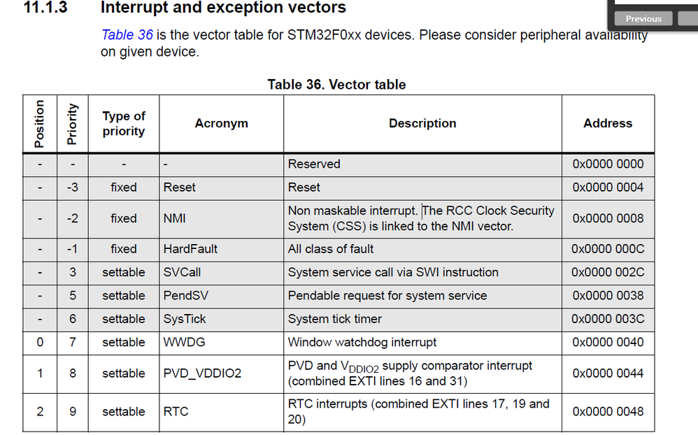

I am asking this because when referring to the Reference Manual I see that the vector table resides at addresses 0x0000 0000 to 0x0000 00BC:
and the end of the table:

2018-06-26 5:09 AM
In STM32F0 the flash is aliased to 0x0 if booting from flash.
2018-06-26 5:18 AM
The CM0 parts it is always at address zero, other hardware then allows for the mapping/shadowing of RAM, FLASH or ROM at that address.
To use an alternate table (ie IAP loader + application) you would reserved some space at the base of RAM, copy your table there, and then remap the RAM so it appears at both 0x20000000 and 0x00000000
For the CM0+ parts the VTOR is available and you can program in an aligned tabled, ie SCB->VTOR = 0x08004000
