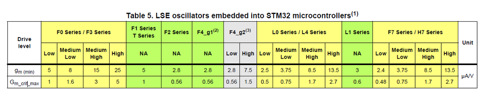

#lse-startup #stm32f1-clock2018-07-03 7:36 AM
Regarding the calculation, you missed a factor of 5 . Pay attention between Gm(min) used in the formula and the Gm_crit_max used in our newer datasheets.
gm [LSEDRV[1:0] = 00]=
0.5 uA/V
=> 2.5µA/Vgm [LSEDRV[1:0] = 01]=
0.75 uA/V
=> 3.75µA/Vgm [LSEDRV[1:0] = 10]=
1.7 uA/V
=> 8.5µA/Vgm [LSEDRV[1:0] = 11]=
2.7 uA/V
=> 13.5µA/VSame for HSE , gm =
1.5 mA/V
=>7.5mA/V
Cheers,
STOne-32
