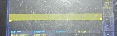

What is the waveform? Can you show the intermittent output on a scope plot?
2025-07-17 7:57 PM
2025-07-17 7:58 PM
The waveforms were captured from the TIM1 pin using an oscilloscope.

It may be hard to diagnose further without knowing what the firmware is doing. Looks like it's not a standard PWM output but rather something dynamic. Even the periods between pulse trains seems variable in your video. The firmware is certainly doing something here.
I would guess that if you programmed a chip to output a basic PWM signal, it would work fine at 60 C.
ST support request can be made here, but I don't think they're going to be able to assist without more information.
