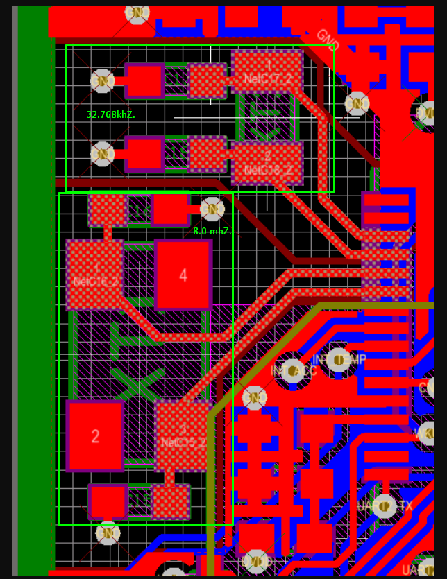

Hi STOne-32,
This is the footprint:
And the track length:
For the 32.768KHz crystal: 6.731 mm and 4.786 mm
For the 8.0MHz crystal: 8.176 mm and 9.874 mm
Do you think the PCB design is good enough?
Best regards.
2018-06-28 1:46 AM
The design seems good. Can you please share all Layers seperatly to check the Vias and Ground connections. I fear there is a ground loop creating a leakage somewhere, but to be confirmed.
Cheers,
STOne-32.

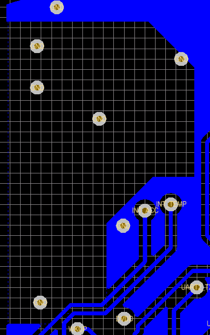

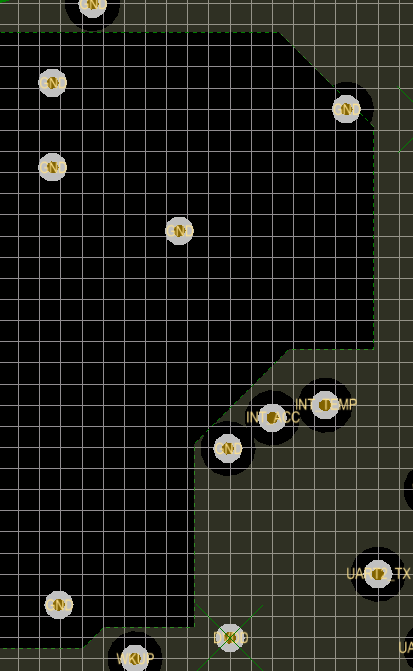

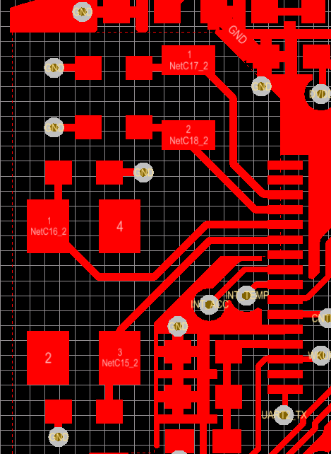

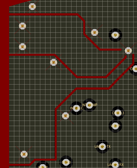

Hi STOne-32,
I'm sorry for the delay. I send you all layers seperatly.
TOP:
L1:
L2:
Bottom:
1. Do you think it is right the design?
