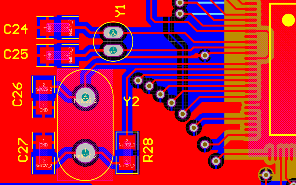

I have read all other posts of LSE problems in the forum and found a lot of info, almost everything related with hardware or PCB layout, well, i have to admit that my pcb layout is not the best and the hardware parts either.

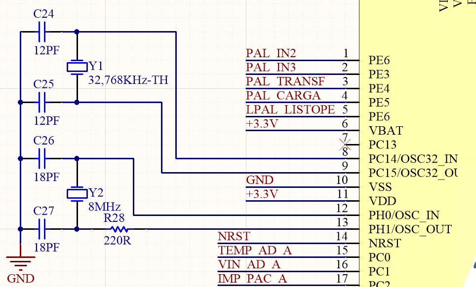

Schematic:
PCB layout:

Crystal: https://www.digikey.com/products/en?keywords=631-1204-ND
Capacitors: 12pF as indicate the crystal datasheet.

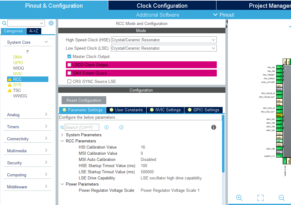

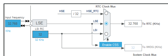

RCC config:
Clocks config:

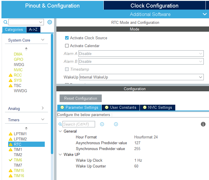

RTC config:

I tried almost everything, changed the LSE startup timeout, the drive capability, tried with different parallel resistors to the crystal, cleaning and drying the board.

I have to change the crystal layout?
I have to change the crystal/caps parts?

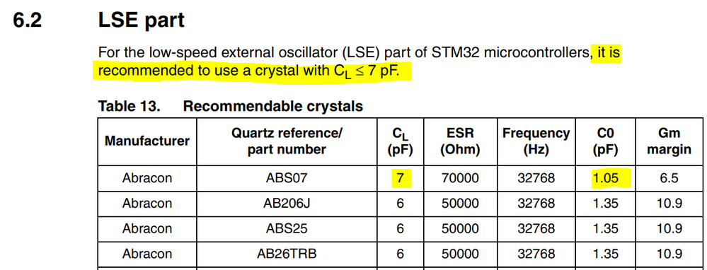

The Load capacitance given by DS does not mean you put two capacitors of that capacitance next to the crystal. Read AN2867.
Without using Cube, after having read the relevant portions of RCC chapter in RM, write a minimal program writing directly to registers, which only starts the LSE oscillator, without any timeout, and indicates when it succeeds (e.g. lighting up a LED).
Experiment with drive strength.
2020-06-24 8:28 PM
C24/C25 are almost certainly too big.
Look at AN2867 for how to calculate what the capacitors should be.
They also list some recommended parts. Note that C0 is way less than what you have.
