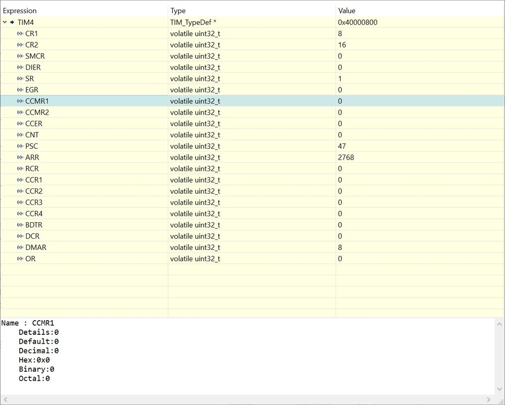

timer state before start with
TIM4->ARR = 128*20+208;

Thank You!!! It`s need to reset slave timer parameters.
TIM2->EGR |= TIM_EGR_UG;
