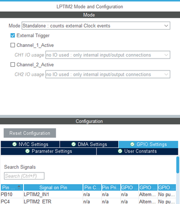

On NUCLEO-H563ZI board I put 3KHz square wave on LPTIM2_ETR (PC4). I want LPTIM2 to continuously count. However the count never increases. LPTIM2 setup...
And

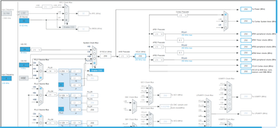

Clock looks like

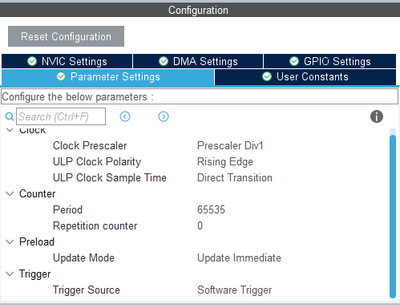

MX_LPTIM2_Init() looks like

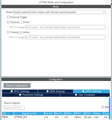

2023-10-12 6:59 AM
Sarra,
Thank you! Using LPTIM_INPUT1SOURCE_GPIO works. LPTIM2 configured with STM32CubeIDE as follows...

2023-10-12 6:59 AM
Sarra,
