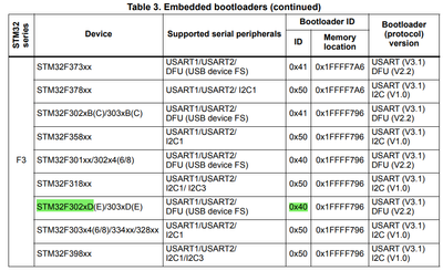

So an update on this after working with an ST technical person.
The bootloader version referred to in AN2606 is the "DFU bootloader" version (of which there are 4 listed near the end of AN3156) not the overall bootloader version for specific chips.
I was referencing the incorrect "version" information.

Thank you for reporting this! According to AN3156, the bootloader version is mentioned as an example not referring to specific product.
According to AN2606, I will check internally and get back to you.

Hello @MButsch
Thank you for your feedback.
Indeed, the product bootloader version refers to the version of the bootloader software that is installed on the product, while the bootloader USB protocol version refers to the version of the USB protocol that is used by the bootloader. You can check the bootloader version by referring to Bootloader ID memory location provided in Table 3. Embedded bootloaders.
