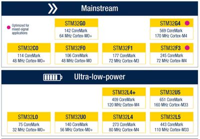

Dear @mlac ,
Welcome in STCommunity, Here is my suggestions our STM32 family offer different options of MCUs and our longevity program is extended each year by +10 Years.
You refer here to see a 20 to 32 pins MCU range : https://www.st.com/en/microcontrollers-microprocessors/stm32-32-bit-arm-cortex-mcus.html
I would suggest either a STM32U0 MCU running at 56MHz if ultra low power is key - battery operation or to select an STM32C0 MCU for price sensitive both series are less then 2 years from launch and benefit from our latest improvements and peripherals and features including software.
Hope it helps you in the decision.

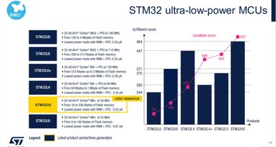

Q1: Roughly how much power can we save with an ultra-low-power part compared to a regular STM32C0 part?
Q2: Are you recommending the STM32U0 over the STM32L0? If so, why?

A1) I believe in this use case . STM32C0 is enough - Cost is key on C0 family
A2) ULP family is used in general when more than 95% of time the MCU is in standby or STOP mode , a bit expensive to have that premium less nA / uA
U0 is only natural upgrade of L0 series with refreshed features of performance and security.

Dear @mlac ,
A1) U0 is recently announced since March 2024, So quite new parts and we are re-filling our distribution inline with market . No worries at all this normal life cycle and new designs take some time to converted to production.
A2) Yes, this is possible in STOP modes thanks to LPUART - also will depend on your Baudrate ? As Wake-up and decoding the RX frame and then continue operating in RUN mode .
