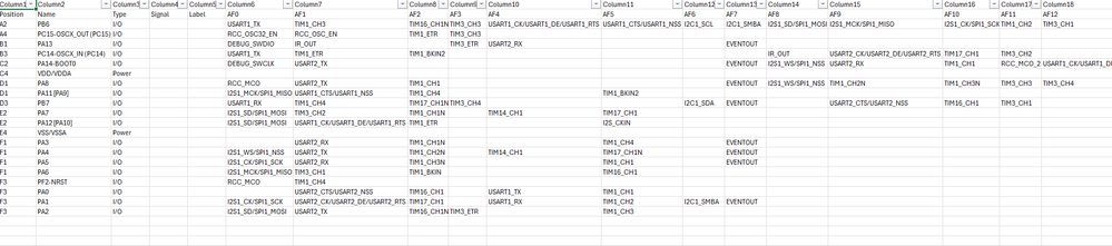

Thanks. The output from CubeMX does the job if I export with alt functions.

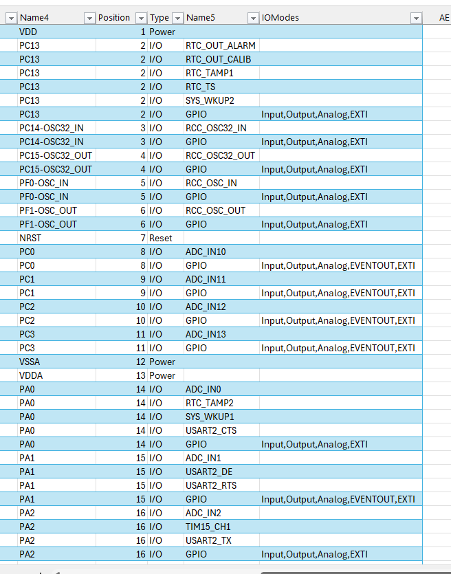

If I download STM32F030R8Tx.xml and open in MS Excel, I see this:
So that doesn't give the full mapping of Alternate Functions - like this:
See: https://community.st.com/t5/stm32-mcus-products/stm32u535ve-pin-configuration-table-excel-or-csv-table/m-p/762040/highlight/true#M270653 by @Amel NASRI
