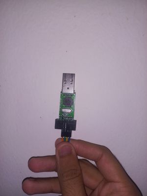

I have ST link V2 mini programmer and it has stm32f103CBT6 ic.
i regularly connect my blue pill using it.

That's a clone / counterfeit ST-LINK, don't expect a lot of support / concern related to fixing issues with that.
The error basically means the connection is non-viable, frequently what you're connecting too and power supplies. Code you put on the device can also impede connectivity, ie reassigning pins, or turning off pins/circuitry require in low-power operation. Assuming you're seeing this on new boards, with blank devices.

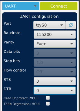

Need an (any) USB-serial adapter, rx/tx connected to the pins with uart/boot function.
Then connect in Programmer to uart ->

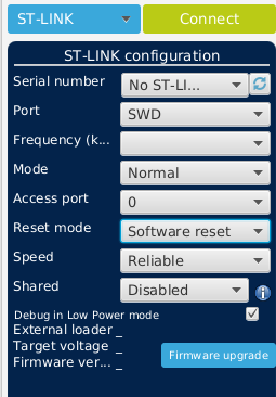

Did you try to connect under "software reset" ? Try. (your clone has no working reset for stm32, usually.)

Late Update: by "programmer" I meant "STM32CubeProgrammer" should be able to connect over UART. if by "programmer" you were asking if the ST-LINK will connect, then no, that's the whole point. It uses the SWD interface. You need to connect USB-Serial Cable and use that connection (UART mode) in STM32CubeProgrammer to connect to the board.
