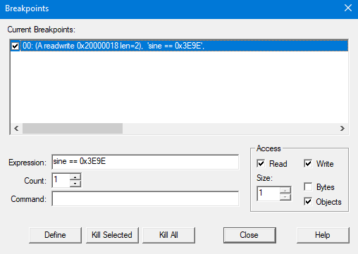

here is my conditional breakpoints settings
I took exercise as <apnt_230.pdf> did at page 11, 15) watchpoints: Conditional Breakpoints.
The application can use conditional breakpoints. Why I can't? I got a dialogue saying that My
target device dose not support conditional breakpoints!
Actually, I am using the STMF407 Discovery board as the
<apnt_230.pdf> using.
So, why?
Turvey.Clive.002
#conditional-breakpointsSolved! Go to Solution.
2018-02-11 1:21 AM
Finally, I found I forget to check the box of Read and Write.
Turvey.Clive.002
Don't tell Bob boys, I make a stupid mistake. ^ ^His notes is very helpful to get the uVision debugger working, and act like a professional.

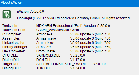

2018-02-10 8:06 PM
SB12 is connected as default.
My ST-LINK firmware updated recently. Version: V2.J29.S0
Here is my KEIL IDE details:
2018-02-11 1:21 AM
Turvey.Clive.002
