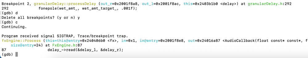

I have been having an issue with my STLINK-V3MINIE for some time now. When I set and hit a breakpoint, the program will often not start again no matter what I do. I am using arm-none-eabi-gdb with OpenOCD to debug a STM32H750, and will set a breakpoint or watchpoint in my code, and once it is hit, I am not able to get the target to continue again using "continue" or "step" commands in gdb. Even after deleting the breakpoint, the issue will remain and the only way to get the target to respond normally again is to reset the program with "monitor reset halt". The image I attached shows hitting a breakpoint, deleting the breakpoint, then not being able to continue
