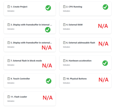

Thank you for responding @unsigned_char_array,
Some of the steps are not available for our set up such as external ram or external flash. But the important ones such as DMA2D and internal ram frame buffer work as expected. See below for the detailed steps.
The TouchGFXHAL.cpp is the stock implementation (attached) since the base class does all the heavy work same way as the DK impl.
I can see the OS Hooks being called, but observing the framebuffer memory in debug shows it to be all black while the screen is supposed to be white (0x0000 vs 0xFFFF).
