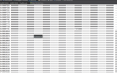

I’m currently working on a routed circuit where I’m interfacing an STM32H735IGT6 microcontroller with an external NOR flash memory (MT25QL512ABB1EW9-0SIT). While most operations seem to work as expected, I’m encountering an issue with programming a page, and I’d appreciate your insights.
When trying to program a page:
Programming Command Execution:
Memory Mapped Read:
Erase Operation:
Write Enable:
Address Alignment:
Flag Status Register Inspection:
I’m attaching:
Thank you in advance for your support and suggestions!

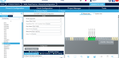

Could you check the device size and the dummy cycle? The size of MT25QL512ABB memory is 512Mbits=64MBytes. So, in STM32CubeMX you need to configure Devise Size = 26.

Device Size Configuration:
I have configured the device size in STM32CubeMX as 26 to match the 512Mbit size of the MT25QL512ABB flash memory.
Dummy Cycles:
I have carefully set the dummy cycles to align with the specifications of the NOR flash, and I’ve verified that the configuration is correct.

I cannot program the first section of the NOR flash (address 0x0). After multiple attempts, I noticed:
Unexpected Behavior:
If anyone has encountered a similar issue or has further insights, I would be grateful for your support.
