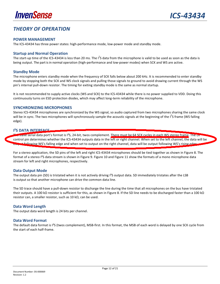

2018-09-17 4:03 AM
> Data per sample : 24 bits
> Audio mode : Mono mode
> Audio protocole : Free protocol
I suspect this is some CubeMX stuff so I wonder what does this exactly mean in terms of SAI registers value and how does it match the microphone's requirement:
