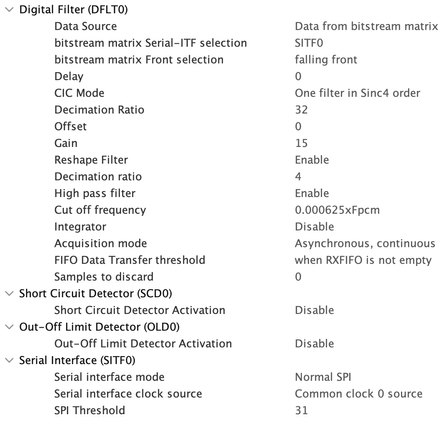

...of MDF:

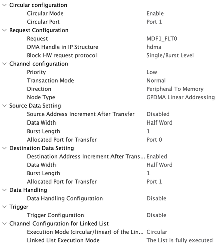

...of GPDMA:

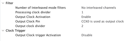

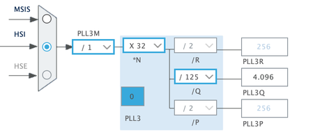

...of the clocks for MDF:

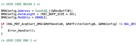

And here's the code to start the recording, from main.c:
(REC_BUFF_SIZE is currently set to 64000 elements, which should be enough for 4 seconds of 16-bit PCM @ 16 kHz).

In this case, the relevant point is that MDF acquisition completion is tied to the DMA transfer length configured in DMAConfig.DataLength, not to the nominal recording duration expected from the application buffer. Here, DataLength is set to REC_BUFF_SIZE * 2, which corresponds to the size in bytes of a 16-bit buffer. If the MDF output is effectively transferred as 32-bit data units, this buffer only holds half as many samples as expected from a 16-bit PCM calculation. For example, a buffer of 64000 16-bit elements represents 128000 bytes, i.e. only 32000 32-bit samples, which at 16 kHz corresponds to about 2 seconds of acquisition. In that case, HAL_MDF_AcqCpltCallback() is called when this programmed DMA length is exhausted, and if HAL_MDF_AcqStop_DMA() is called in the callback, the recording stops at that point.
2026-04-27 8:17 AM
Hey @Saket_Om,
thanks for your reply!
I also experimented with the DMAConfig.DataLength parameter, since I had the impression that I might have made a mistake there as well. However, that didn’t get me any further.
I just conducted a simple experiment: if I double the size of the memory buffer (say, to 128,000 16-bit elements, which would result in a DMAConfig.DataLength of 256,000 bytes, which in turn should result in 8 seconds of audio), I would expect the length of the recorded audio to also increase to at least 4 seconds...
In my case, it doesn’t, and it remains at 2 seconds.
Other than that, shouldn't the DMA controller (or the HAL) take care that the data is being transferred correctly (i.e. 16 bit) if the data size parameter of the channel is configured to be "Half Word"?
