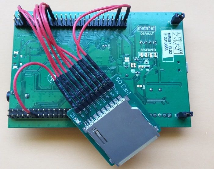

Ended up wiring up a new socket to the F4-DISCO, and testing with that on both SPL and HAL code bases
