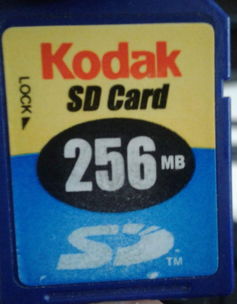

I am using stm32F411RE discovery kit. i generate a code with the cubeMX4.25, the 4GB SDHC card is working fine but when i tried with the 256MB SD Card it was not working. I am getting error 'FR_NOT_READY' in f_mount function.
Other SD Cards (4GB and 16GB) are successfully mounted and file can be written/read.

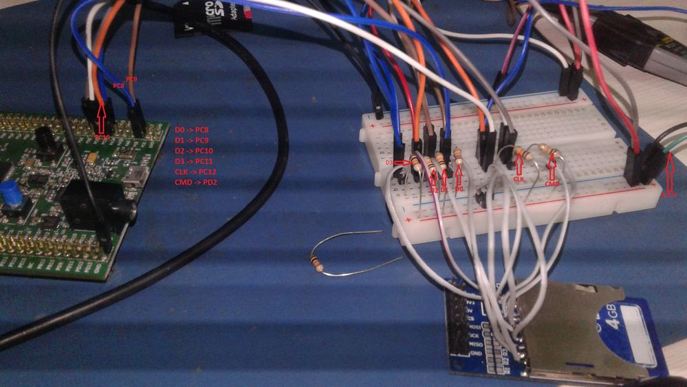

my basic requirementis256MB SD Card using 4bit SDIO.

We Found a problem with SD Card Socket there is all data pins are shorted in the module. now we can read write in 4GB and 16GB card with DMA and Without DMA using 4bit and 1bit modes. 4GB(SDHC class-4) Card is working at 2MHz frequecy and the 16GB(class-10) Card is working at 500KHz.
In the Hardware we have pulled up the lines with the 47K resistors.
But still the problem is same that the 256MB Card is not working at any frequencies - (from 300KHz to 8MHz).
Is there any changes required specific for 256MB Memory Card.
We are using this memory card to store the data.
