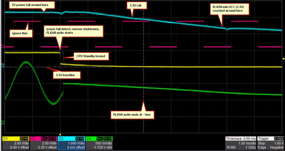

You are right; shutting the CPU reduces the power draw only about 2x, but is still worth doing. I posted some scope traces at the link above.

I can see that is possible but in this case it was not a planned feature.
This is what it looks like currently:
