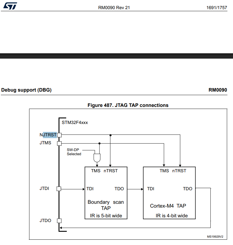

In SPI usage, PB4 will be driven (by the SPI Slave's MOSI) so one needs to arrange for that signal to go tri-state when NJTRST=0. But what does NJTRST actually do? It came up here
and it seems you can ignore it. I have a 10k pullup on it but otherwise do not use it. However I never set it to 0, which is exactly what will happen if you use it for SPI.

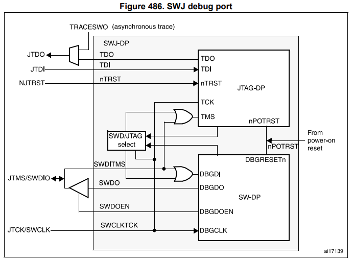

@PHolt.1 wrote:But what does NJTRST actually do? It came up here
The thread says it just resets the debug controller.
It's only relevant if you're using actual JTAG - not SWD.

PS:
With SWD, there is no external reset for SW-DP - just the overall chip reset from NRST or power-on reset:

OK so one needs to be sure that putting muck on NJTRST does not break anything.
EDIT: just seen your PS. Can we be sure waggling NJTRST will not break anything, either during FLASH programming or during code execution?
Stuff appearing on NJTRST could well violate reset timing specs on the TAP controller.
