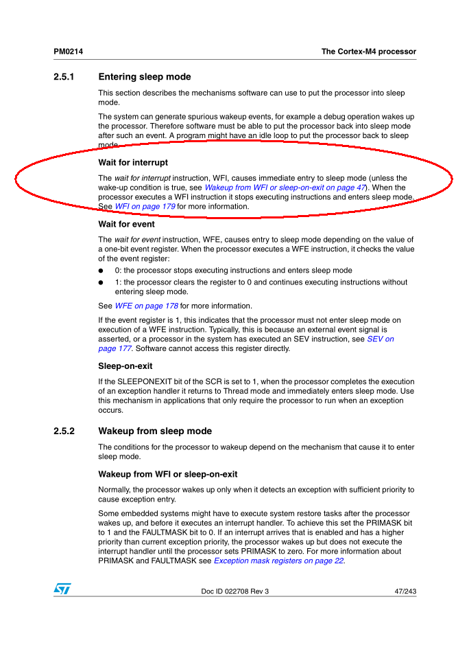

> I don't get what __WFI is supposed to do.
2022-03-12 12:44 PM
Thank you. I didn't know that manual existed. Still, the answer is not simple. Quoting, page 48,
"Normally, the processor wakes up only when it detects an exception with sufficient priority to
cause exception entry."
and that could be a whole lot of things.
I wondered if one has to disable ALL interrupts before doing WFI. I am disabling WKUP and Systick.
