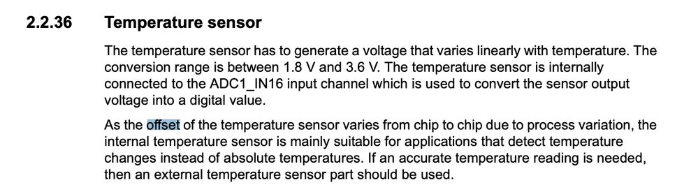

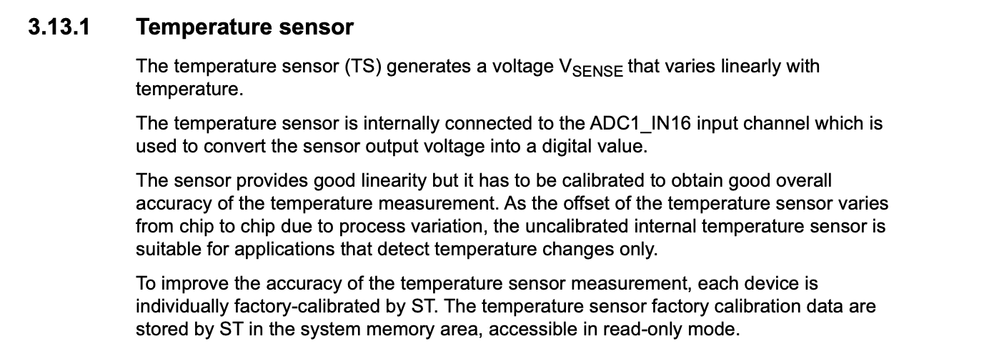

F3 note in data sheet
F4 note in datasheet

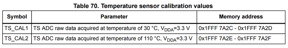

To me, the datasheet sure implies the devices are calibrated at the factory.
Anecdotally, the STM32F4 temperature sensor has always seemed accurate to me to within 1C or so. Wouldn't expect that without calibration.
The reference manual claims precision is +/- 1.5 C.
