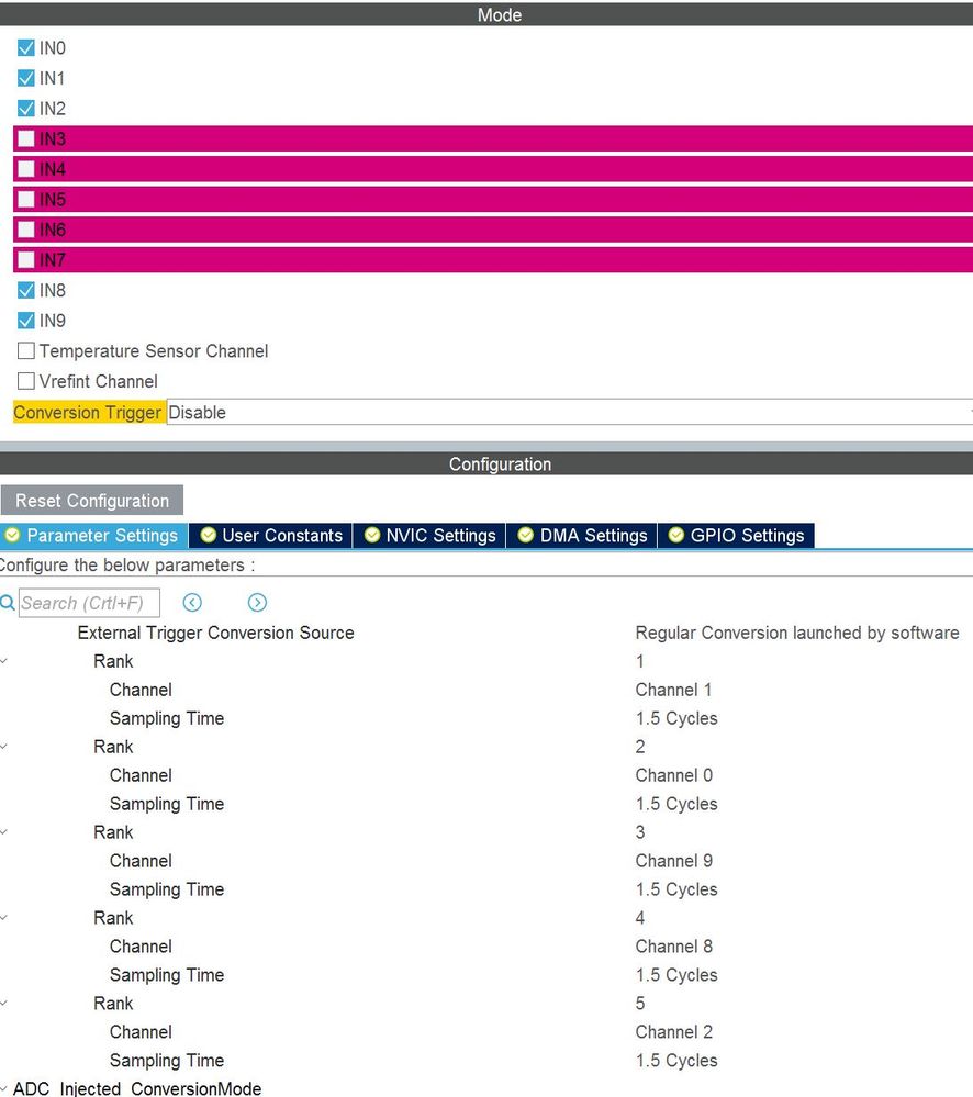

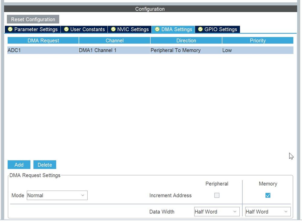

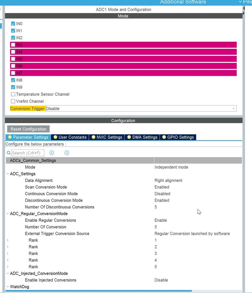

I want to use an ADC with DMA in a STM32F103. I configured it in Cube as you can see in the following picures.
When I start the conversion with
HAL_ADC_Start_DMA(&hadc1,(uint32_t*)AdcData,5);
HAL_ADC_ConvCpltCallback() is called and I see that the AdcData values all changed.
Unfortunately the first rank is sampled twice and the last rank is lost.
I tried to extend the DMA length to 6 but then I do not receive the callback.
I tried to extend the DMA length to 4 but then the last AdcData is unchanged.
Has anybody an idea why this happens and how I can get rid of this?

2020-07-03 6:19 AM
Read out and check/post the ADC registers content.

2020-07-04 3:26 AM
Discontinuous mode is intended to convert a subgroup of the sequence defined in ADC_SQRx. But you set DISCNUM to the same value as ADC_SQR1.L. That doesn't make sense, so just simply don't set DISCEN.
2020-07-04 12:41 PM
Hello JW. Thanx for your answer.
Though your answer sounds feasible it doesn't solve my problem.
I set discontinuous mode to "disabled" and regenerated the code.
What I now see is that in the second scan cycle the DMA waits endlessly for data.
I debugged into the HAL and saw, that setting the DMA bit in ADC_CR2 causes the ADC to execute a conversion! This is later the unwanted data..
