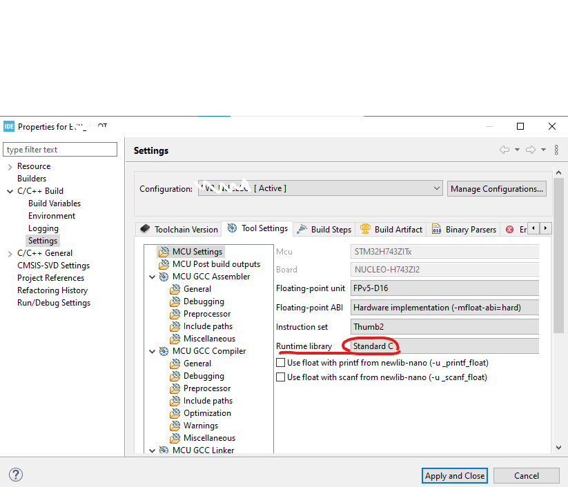

2021-02-24 2:13 PM
Select this:
2021-02-24 5:36 PM
I got it!
You have to select the project, then File->Properties. To get to that screen.
Thanks, that fixed it.
