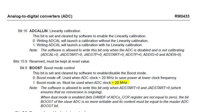

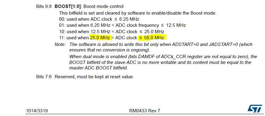

The Fadc is about 32Mhz .Is BOOST bit(s) set? (boost functionality differentiates with chip revision Y or V)
2021-02-23 12:23 AM
Thanks for reply! I changed the conditions in callback like you say. I was not aware of boost mode, it was on reset state. My chip is V revision, and I set the these two bits and I also observe in SFRs they changed to true state. But there is no timing differences.
