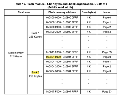

The chip has 512 kB of flash, so 0x08080000 is outside of those bounds, regardless of how DB1M is set.
Second bank of flash starts at 0x08040000.

Wow, I can't believe I missed that. I've been relying on the value of the linker script from STM32CubeMX:
FLASH (rx) : ORIGIN = 0x8000000, LENGTH = 1024K <----
But now I realize that linker script is generic: `STM32L4P5XX_FLASH.ld`. That was a little misleading. Thank you for the help!
