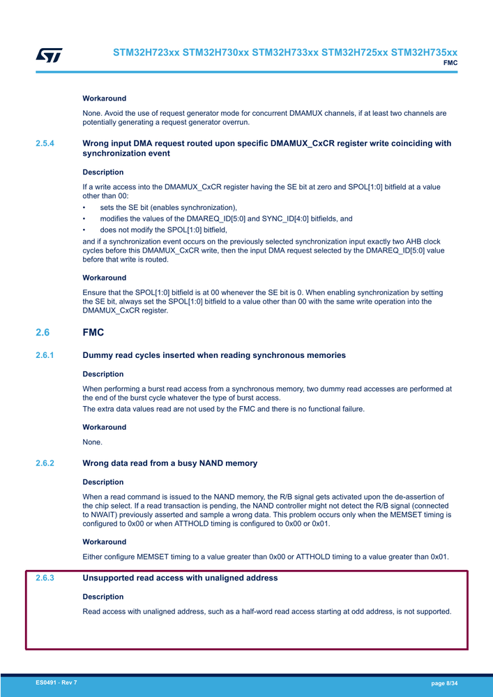

2023-03-25 12:44 AM
We want to use external 16 bit SDRAM for heap and stack. The SDRAM is configured with byte enable and MPU. I tried to map the memory to 0xC0000000 and 0x60000000, but it doesn't matter. Also the configuration of MPU with MPU_TEX_LEVEL0 or MPU_TEX_LEVEL1 doesn't matter.
An unaligned read/write with 16 bit is possible. So I think a unaligned read/write with 32 bit should possible too, if the compiler handles the access in the right way.
We use GCC 9.3 and it doesn't work.

2023-03-25 4:34 AM
That you were able to perform some unaligned accesses, may be coincidental.

2023-04-20 11:30 PM
Unaligned access to 16-Bit SDRAM via FMC is possible in our project with the following settings:
SDCache enabled
MPU enabled
MPU Settings
MPU_InitStruct.Enable = MPU_REGION_ENABLE;
MPU_InitStruct.SubRegionDisable = 0x0;
MPU_InitStruct.Number = MPU_REGION_NUMBER4;
MPU_InitStruct.AccessPermission = MPU_REGION_FULL_ACCESS;
MPU_InitStruct.BaseAddress = 0xc0000000;
MPU_InitStruct.TypeExtField = MPU_TEX_LEVEL0;
MPU_InitStruct.Size = MPU_REGION_SIZE_16MB;
MPU_InitStruct.DisableExec = MPU_INSTRUCTION_ACCESS_DISABLE;
MPU_InitStruct.IsShareable = MPU_ACCESS_NOT_SHAREABLE;
MPU_InitStruct.IsCacheable = MPU_ACCESS_CACHEABLE;
MPU_InitStruct.IsBufferable = MPU_ACCESS_NOT_BUFFERABLE;
