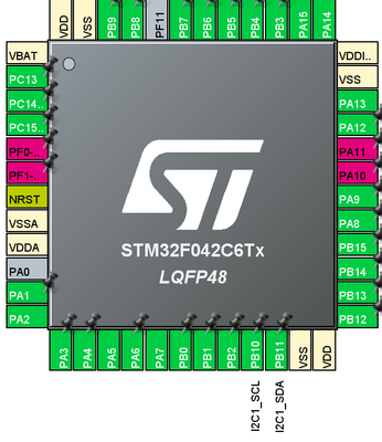

i set primary I2C on PB10,11 as on image an reserve PA10,11 and PF0,1
My plan is use alternative AF as I2C switch similar as IC PI4MSD5V9540
On PF pins is device on 5V I2C .
In code i try add to one I2C1 (have only one) PF pins when PB is active.

HAL_GPIO_Init(GPIOF, &GPIO_InitStruct);On scope seem signals is separated and address is send (HAL_I2C_Master_Transmit one byte) and ACK on PF pins, but no next data send. Seems somethink in HAL is broken after pin add.
When code deinit PB and only switch full pins to PF + init back com works ok.
Exist way to use more as one AF pin ?

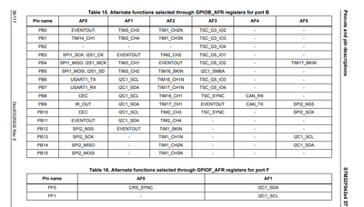

Where i can find symbolic schematics for AF switching matrix?
see ds : pinouts ...alternative...
2024-04-20 1:44 AM
All this is ok , i try somethink undocumented. Table isnt schematics , but thanks
