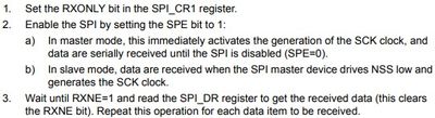

Referring to the RM0090 Manual programming SPI Receive.
Code:
/* CS Enable */
GPIOA->ODR &= ~(1<<4);
/* Enable SPI, SPE = 1 */
SPI1->CR1 |= 0x0040;
/* Check RXNE flag */
if (__HAL_SPI_GET_FLAG(hspi, SPI_FLAG_RXNE)){
*data_ptr = (uint16_t)hspi->Instance->DR;
*data_ptr += sizeof(uint16_t);
SPI1->CR1 &= 0xFFBF;
/* CS Disable */
GPIOA->ODR |= 0x0010;

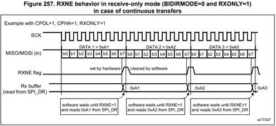

In theory, if the SPI frequency is too slow, we need to provide a sufficiently large value for the "timeout". However, in practice, what is observed is that when the SPI frequency is configured to be too fast, it results in the SPI function waiting until timeout due to Timeout.
Quoting [1] by waclawek.jan:
"If the baud rate is low and/or compiler optimizations are enabled, the test will happen before that extraneous frame is received, and the RXNE flag set afterwards will cause problems when starting to receive the next frame. In the other case - as happened here - the extra frame is received completely and RXNE is set at the time of the test, then the code waits until timeout (potentially forever if set so), as there's, of course, nothing which would clear RXNE in that waiting loop."
[1] SPI receive times out due to SPI_FLAG_RXNE not reseting in SPI_EndRxTransaction.
