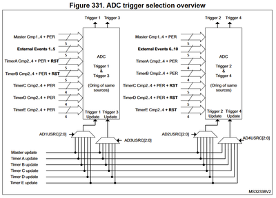

In my project I need to sample 3 phase current to see if where is short or not. I am using STM32H753 HRTIM. Not only that I must place sampling point as close to PWM transition from high to low as possible (peak current)
I connected phase current measurement to ADC1, ADC2, and ADC3 thinking that I would simply use each ADC with DMA, so I would always have data ready in my HRTIM update interrupt.
Problem is that only two channels are allowed to be regular (TRG1 and TRG3), and two must be injected (TRG2 and TRG4).

But when I try to use TRIGGER4 from HRTIM, well, I don't get any data, while I do sampling event of scope (10k resistor to VDD, and I see low voltage glitch down, that position can be controlled based on CCR register value, so this part is working)
LL_ADC_INJ_SetTriggerSource(ADC3,LL_ADC_INJ_TRIG_EXT_HRTIM_TRG4);

I was unable to do it, so just reading injected ADC channel register in timer update, and it looks like working.
