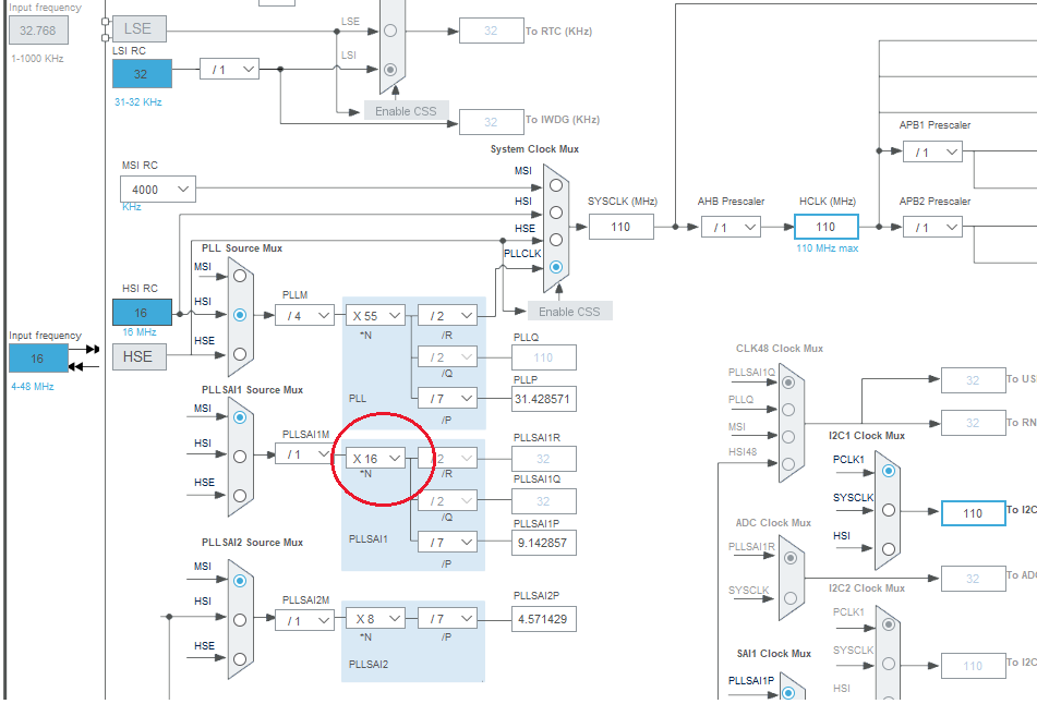

I connect my I2C but when I connect an oscilloscope I have nothing on the clock signal. So probably I misconfigured my clock. Could you give me the information? Thanks in advance.
In this picture below I've a warning, do you know how to remove this warning please ?

2023-03-07 3:46 AM
It's very strange when I come back to the '.ioc' I have a error and I selected resolve the error automatically. Now I have this configuration :
Normally the value is 8 but now it's 16. So I cant try again.

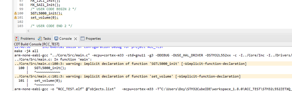

2023-03-07 3:48 AM
I have a warning :
Implicit declaration what does it means ?

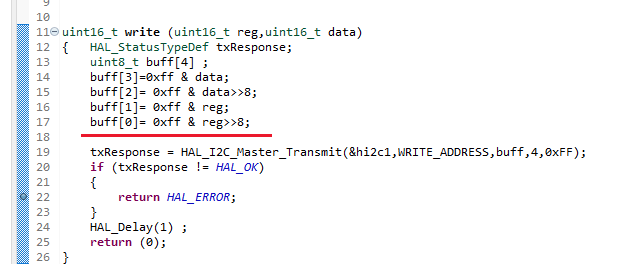

2023-03-07 5:06 AM
Sorry I have another error :
buff[0] had to make a shift. But I have always the same error.
2023-03-09 1:11 PM
Did you add the prototypes?
2023-03-09 1:16 PM
Yes I have developed prototypes but the error comes from SysTick as I sent you an email. How to configure the SysTick with my evaluation Board STM32L552E-EV ? Just to check if my board still works.

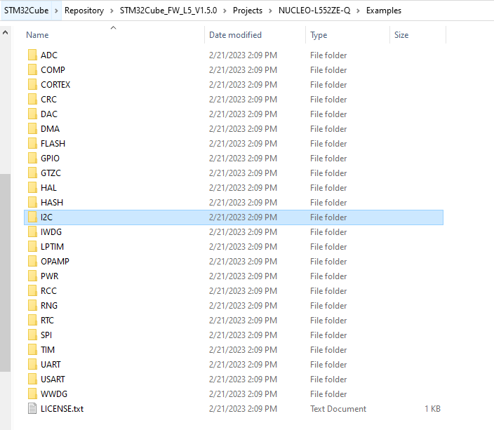

2023-03-09 1:33 PM
You can use this I2C example. It's the same STM32L5 family and not tied to a specific development board.
