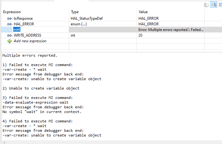

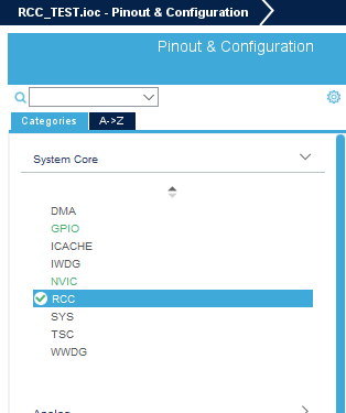

I connect my I2C but when I connect an oscilloscope I have nothing on the clock signal. So probably I misconfigured my clock. Could you give me the information? Thanks in advance.
In this picture below I've a warning, do you know how to remove this warning please ?
Thank you for your helps.

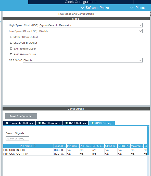

2023-03-06 7:57 AM
I'll try it tomorrow. Thank you for your patience.
2023-03-07 12:04 AM
I come back again, after having listened to your advice, I do not encounter any warnings or errors.
After, this step how can I check if my clock is running correctly on my evaluation board? For example, can I test the HAL delay function ?
I just to check this step before continuing to configure the I2C and then SAI.

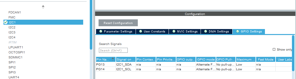

2023-03-07 12:13 AM
I also configure I2C and no warning and no errors.
2023-03-07 1:46 AM
After configuring the RCC, I2C and SAI I still have an error at the I2C level
Something is wrong but I don't know where it could come from

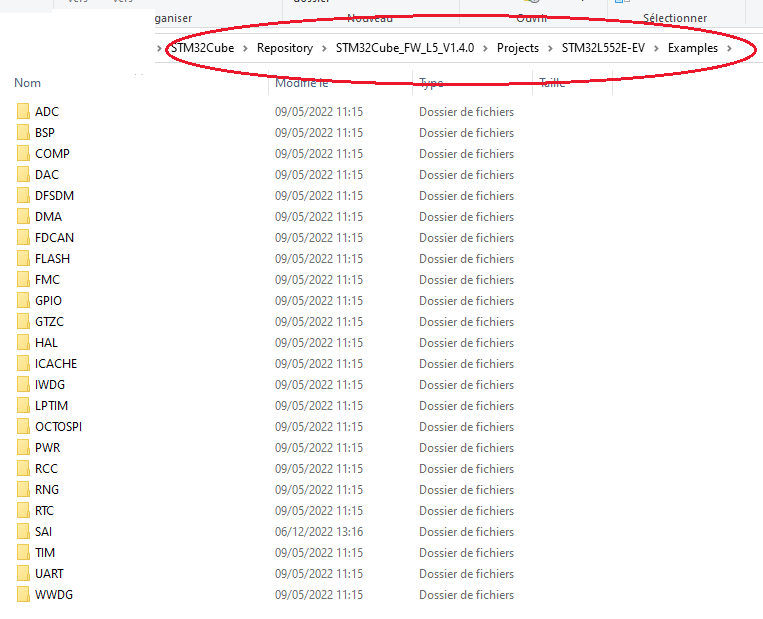

You can refer to the I2C WIKI : Getting started with I2C - stm32mcu
Also you can refer to the CubeFW to find the I2C examples : STM32Cube\Repository\STM32Cube_FW_L5_V1.4.0\Projects\

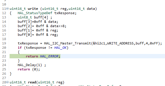

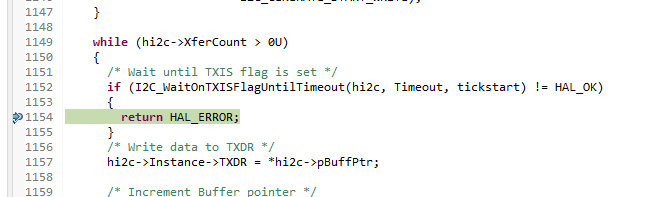

2023-03-07 3:37 AM
I can locate the error inside the function
And the error is that this point
I don't know the signification of this error. Do you have any idea ?
