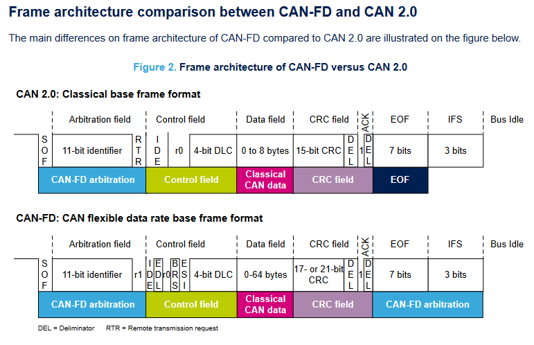

2022-02-18 5:23 AM
What about the CRC length if a CAN 2.0 MCU communicate with a FDCAN MCU in classic mode ??
2022-02-18 5:49 AM
In Classic mode, FDCAN behaves as classical CAN.
See example provided in STM32CubeH7 under the path: Projects\STM32H743I-EVAL\Examples\FDCAN\FDCAN_Classic_Frame_Networking
This example shows how to send/receive classical CAN frames using FDCAN peripheral to/from STM32 MCUs featuring bxCAN like STM32F1, STM32F4 families etc ..
