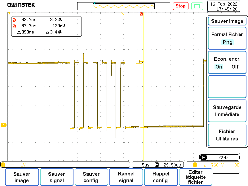

Hello, I m using the CAN bus on a STM32f412. It is connected to a transiver with a CAN analyser linked. I can receive messages without problem but i can t send any messages. Here is ho i configured the CAN :

}When i try so see frames with an osciloscope i get this :
So you can see the communication abort too early and i think it's because ther isn t stuffing bit.
2022-02-17 2:22 AM
It seems there is no error in your code. Can you please share your project, the clock source and the baud rate to further check the configuration ?
Also, you can refer to CAN example provided in STM32CubeF4 via this link STM32Cube\Repository\STM32Cube_FW_F4_V1.x.y\Projects\STM324xG_EVAL\Examples\CAN\CAN_Networking
I suggest to run this example on your desk.

2022-02-18 6:46 AM
Unfortunately, i can t send the whole project. but here is the clock configuration :

}And the baud rate is at 1Mbit/s.
I also tested the same configuration in loopback mode and here i hadn't any problem, i received and sent valid frames. Moreover i had the good signal on Rx and Tx pin.
