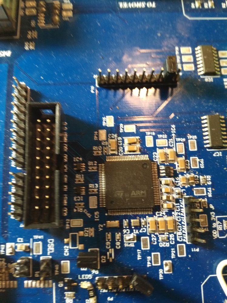

A beginner's question; How to program the 32G4, is it through the UART and if so which terminals to use?
2019-12-11 7:41 PM
Should be some JTAG/SWD pins you can use with an ST-LINK or similar pod
AN2606 should cover USART options https://www.st.com/content/ccc/resource/technical/document/application_note/b9/9b/16/3a/12/1e/40/0c/CD00167594.pdf/files/CD00167594.pdf/jcr:content/translations/en.CD00167594.pdf
Tool, STM32 Cube Programmer https://www.st.com/en/development-tools/stm32cubeprog.html
2019-12-16 9:25 AM
Thanks. Still trying to figure it out. Here is a pic, I think it is the 2-row connector to the left of the micro.
